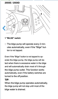

As for the bilge pump, we bought a new/demo 2025 255XD and I am under the impression that the bilge is completely automatic, even when the batteries are turned off. Do I need to do something differently to protect our boat?

Well either you or Yamaha is wrong about the automatic bilge pump.
This function works automatically, even if the battery switches are turned to the off position."
The op does not have the same bilge pump, he has the older style. Which i did have the same style as his and it is off when batteries are off. I tested this system and NO power to the auto bilge pump when batteries are switched off.
I have not checked this on my new 252se, but it is a totally different pump than the older auto pumps
I just went out and checked my 26 252se and it has power at the auto feed to the pump with batteries off but. Mine does not cycle every 2 minutes. I know for a fact it goes on with water level, so it must have a float internally, which according to my owners manual it should cycle every 2 minutes which is wrong.
