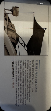

I noticed that the 24-25 Bimini have an additional attachment point for a rear sunshade kit that Yamaha sells. Somewhere I have an accessory catalog, let me see if I can locate it.
For reference, here is the sunshade. I know I ultimately didn’t answer your question, but believe the difference in model numbers is as you eluded to, solar panel, without and then the newer design to accommodate the sunshade.
