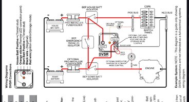

I would imagine the only option would be to run new power wires for accessories that would be on house battery. Which existing factory wires would be wired to the switches? Attached are BEPs diagrams on wiring the switches.

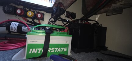

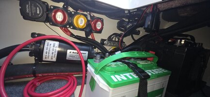

Currently, I am adding an auxiliary fuse box that will be under the helm. Running 8 awg wire from the house switch to a 30A breaker then up under the dash. The plan is to pull power from the aux fuse box for the radio, USBs, and any other future low draw circuits. I think this may be the best course of action just help keep frustration and factory harness intact.
As far as the factory harness battery connections that currently run the connext, ECM, and other critical components that originally connected to the ON/OFF switch, to the Start switch. This way critical components are all on the same battery and should help with keeping voltage fluctuations to a minimum.
Also did the DVSR mod where connecting the small red trigger wire to the load side of the start switch. When the boat is on the water, switch is on, engaging the DVSR to do its job. Then when off the water, switch is off, and batteries are isolated. Allowing for individual battery chargers to charge at home. At least to my understanding this is this should work.
Adding an amplifier for the stock speakers as well in which will run off a 60A breaker feed from the house switch.
This should isolated all of the stereo system and USB chargers to the house circuit. The only thing that should be drawing from the start battery while floating is the connext in float mode. Im assuming transducer and such will also be drawing from the start battery. Not sure if it will be worth while to try to isolate these circuits to the house battery or not. Shouldn't be an issue unless you were floating for like two days. Would need to test the amp draw on start battery while in float mode to be certain.
