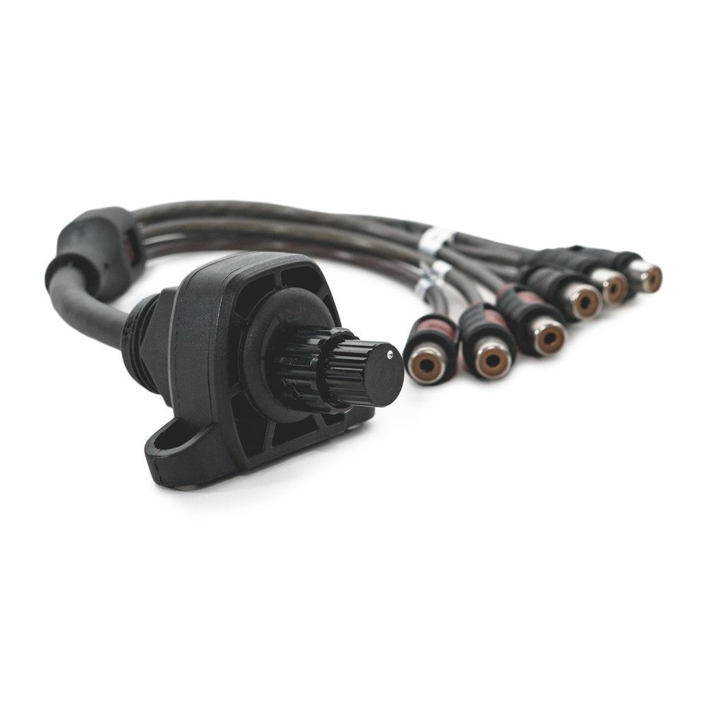

I use two of these to control zones on my boat. Each one splits 2 rcas into 4.
They work well, no noise or anything.

I went 6 zones it was easy to use two Eqs on the 2017 model one RCA to each EQ that feed 4 amps with six pre amp RCA signals then the amps run to 20 speakers / subs . Boats need a lot of fine tuning and require different set ups based on how its being used and the type of music being played. This set up is very easy to adjust while on the fly with out being distracted trying to look at screen and go layers deep into menus to adjust.
