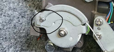

I’m switching out Perfect Pass for Ridesteady. The first step is to restore the throttles to factory settings. I’m sure there is a simple trick to get it, but how do you connect the end of the throttle cable to the potentiometer? It’s 90 degrees and 1000% humidity, so the sweat wasn’t helping, but I couldn’t get it to stay in that hole to save my life.

Rotate the cam all the way clockwise; the wire should go through the slot as you push the plug thingy all the way through both sides of the cam.
If you don't rotate it, it will be very difficult...
