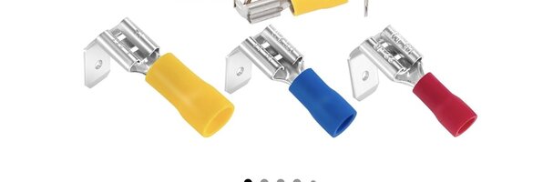

Installing a fishfinder plotter combo. Looking to wire to this open accessory switch. What do I wire the ground to? I dont see a ground block anywhere.
Splice into that black wire looping between all the switches. I used a y-connector on the black wire on the lighter/charger. Or the better solution is to run a new power block from your battery if there is any chance for future expansion. Eventually I did this.
