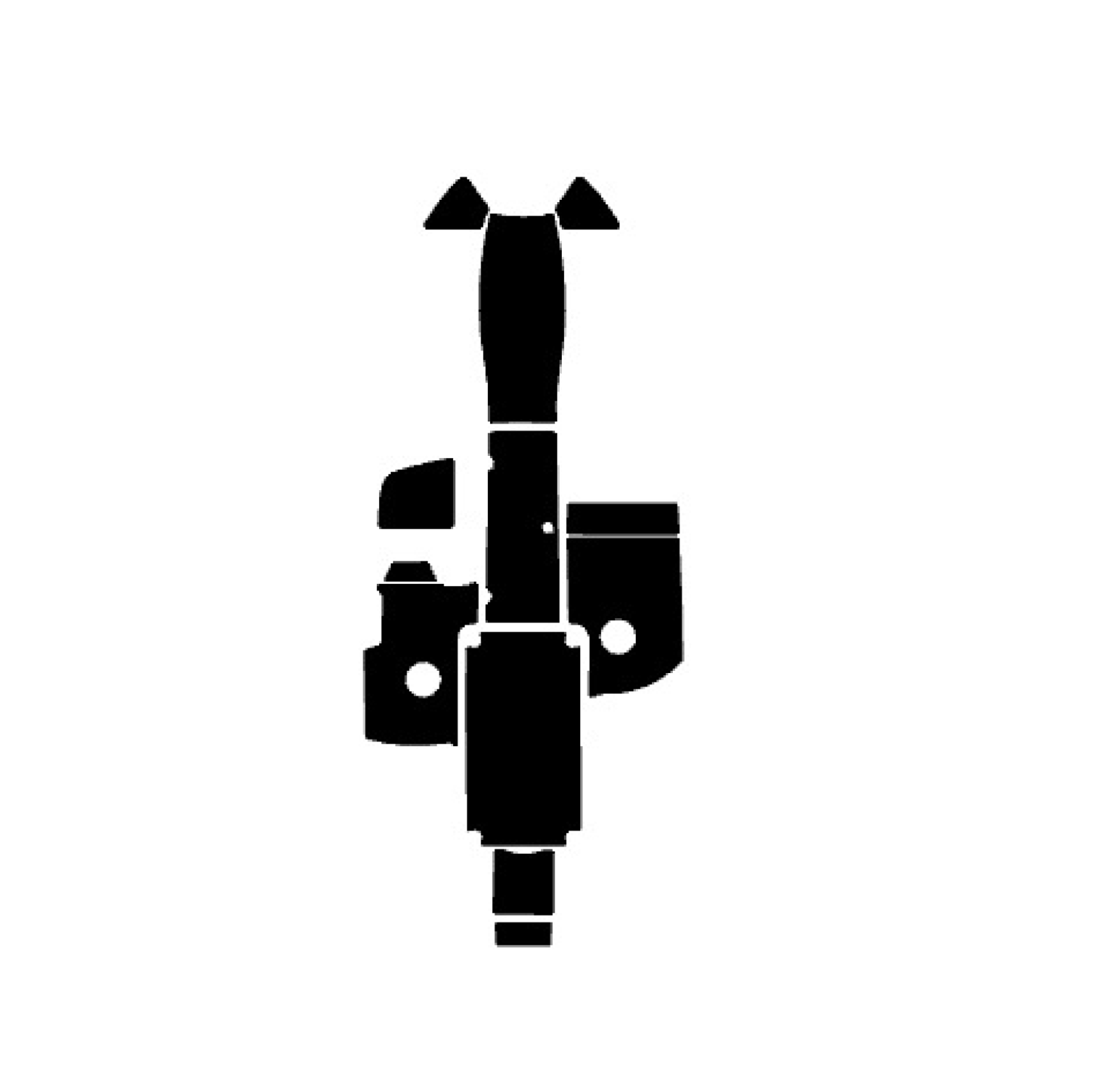

What about this option.
That’s a great price, especially if they offer different color options. As I recall black tip material is a lot like hydro turf and the black tip name is a west marine brand. They used to offer water shoes and fishing gear as well. Once upon a time they’re wee eBay users that offered supplemental interior black tip kits .
