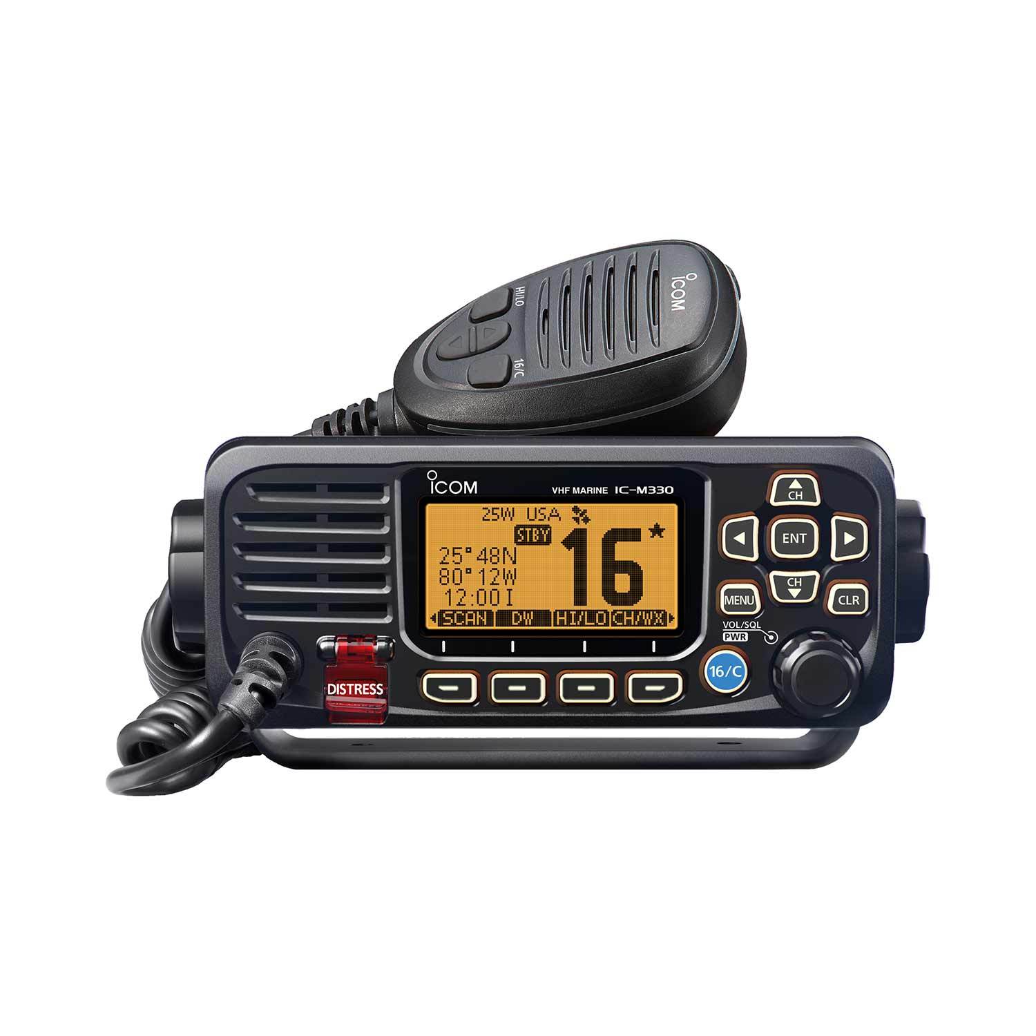

I researched VHF Radios for quite a while, and ultimately decided on the Icom M330G.
It has all the features I wanted, plus GPS.
You'll also need to buy the flush mount kit.

Finally, I mounted the Glove Box and Radio in the black plastic plate, and checked for fit.
The VHF Radio is installed using the optional flush mount kit.
