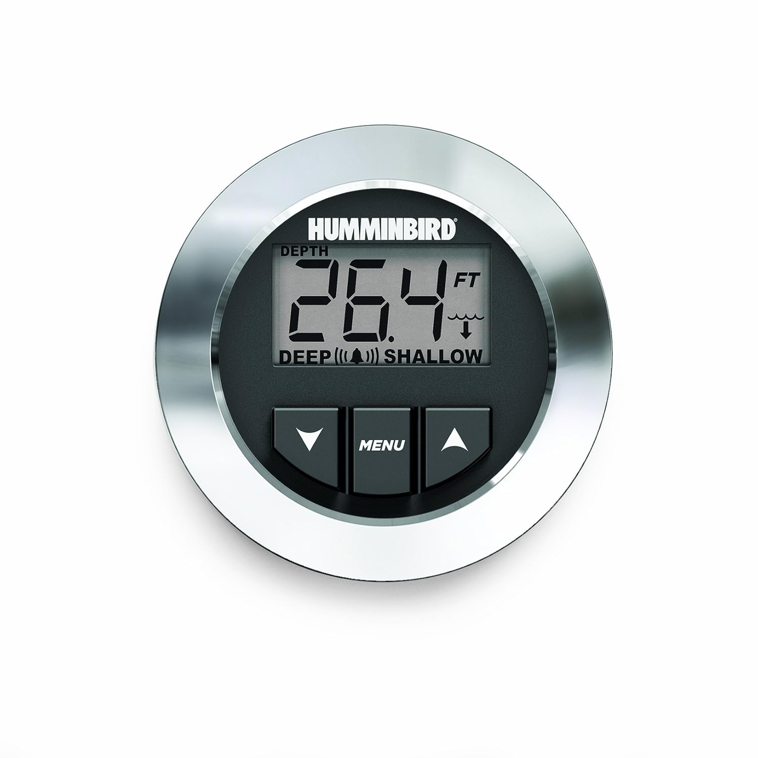

When I bought my SX230 the depth gauge did not work.
To stick with the OEM look I ordered a new one with the temperature display added.
Despite replacing the gauge and transducer it did not work consistently and seemed to never have a reading when I needed it.
I previously installed a Humminbird HDR-650 in my LX210. It always worked, read shallower depths and it had an offset adjust for the depth so that you could have an true depth reading.
I upgraded to a Raymarine Dragonfly in my SX230 and replaced the Norcross unit with a voltage gauge.
But, in hindsight, if I wanted to stick to the factory location I would buy the HDR650 instead of another Norcross.
This is what the HDR650 looks like. It would not be a prefect match but it works!

@Lspeedss, I installed the humminbird in my LX210 where it worked perfectly. The gauge uses the same size hole and I mounted the transducer in the same place that it is mounted on the SX230.
