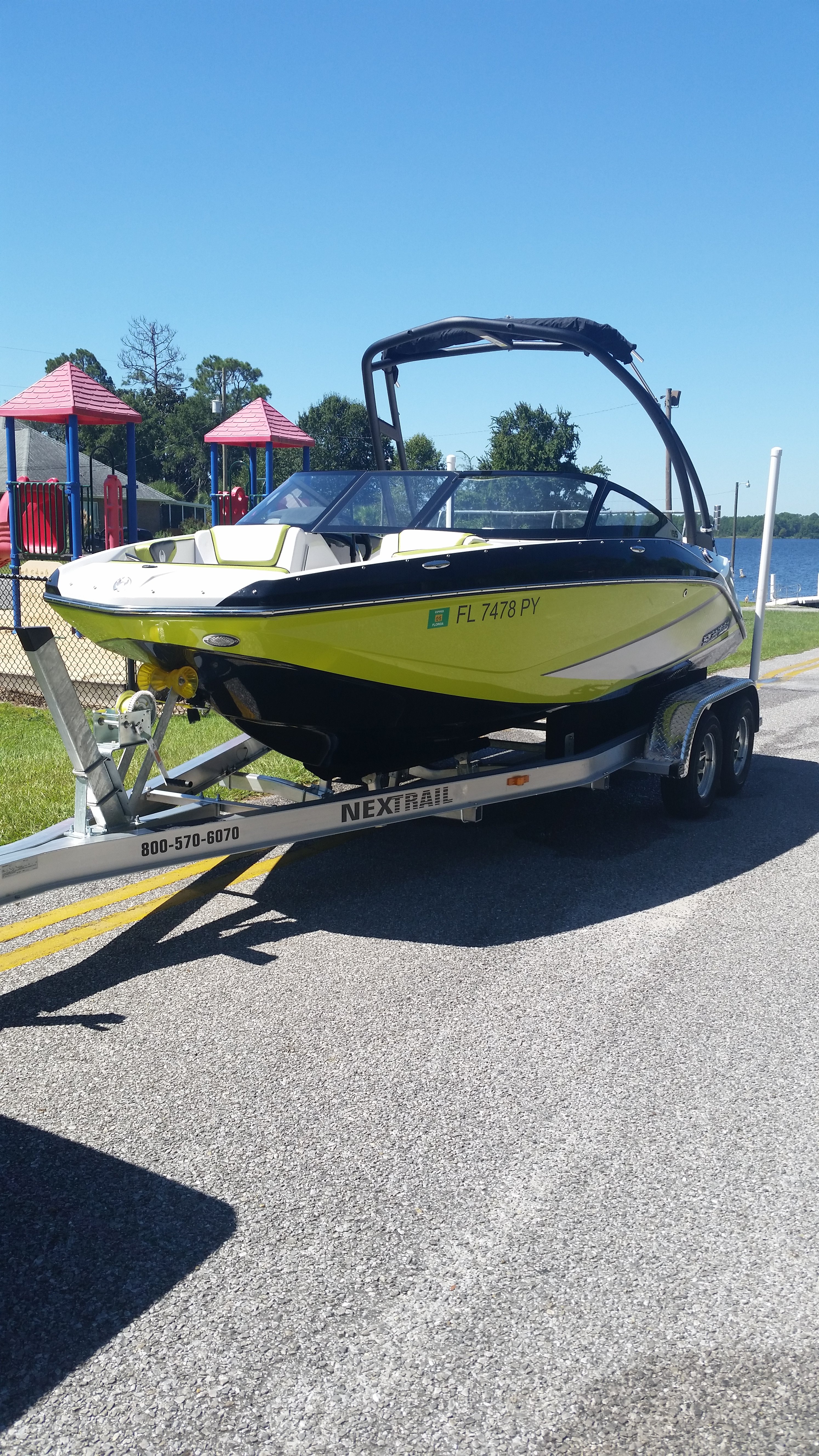

This is what I bought for my boat... So far no issues and I like the tandem axle..
Slugger55
489
299
212
Jasper, AL
They are located in Ocala, FL they build to order and ship it to your driveway. All said and done $3100. Hydraulic brake on front tandem. The more options the more it costs. The salesman who you talk to has a silver tongue, don't let him suck you in... Delivered when promised... http://nextrailtrailers.com/boat-trailers/
Here is some information I provided to another member: The 1-800 number you call you get a guy by the name of Lance. He says that he needs your year, make and model of your boat, but the trailer needed to be adjusted to fit the boat. The guy who delivered it helped with this process, but I had to make more adjustments for the winch height. You will find this out when you recover the boat with the new trailer. Bring a 3/4 inch ratchet and wrench with you to accomplish this. I am pretty impressed with the construction of the trailer. You will also need to install the rear guides (need a 9/16 inch deep well socket) and adjust them to beam width of the boat. I used a impact driver to tighten. It tows nice and the ride is a lot better with the tandem axles. I had disc brakes (hydraulic style) installed on the front axle and it does more than enough to help with braking. I wasn't impressed with the salesman telling me that it would be tailored to my boat, but I am highly impressed with the product. $160 to deliver it to Panama City, they dropped it right in my driveway. No rear tie down straps, I am going to add them later.
I hope this helps you out....
