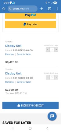

His is for a 212x not a 242x i doubt the part numbers are the same yamaha changed a lot between models and years. Go to boats.net and verify the numbers. Yours goes for 7kish and his is around 2k

They may plug in and look the same but why the different part numbers and different prices. I have talked with my contacts at yamaha and they are different. Facts are facts. Just because something may seem similar doesn't make it the same.
I work on these things for a living and know if the part number is different then the part is different and you dont use it just because someone says its the same
