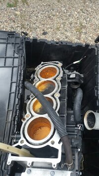

When fogging, do I need to take this air box off completely or can I just undo the small hose shown in the middle of the picture that connects to the very large hose and spray it into the large hose from that opening ? Trying to bypass having to take this airbox off ...
I fog directly in cylinders by pulling the plugs.
My motors are naturally aspirated, so I’m not sure how much the supercharger restricts fluid flow. The key step is to remove the spark plugs at the end and spray directly into the cylinders. The idea is to coat the cylinder walls, since that’s the area most prone to corrosion, and protect them from rust caused by moisture. I do wish the water box/muffler had a drain—when the leftover water evaporates, some of that moisture could easily work its way back into the cylinders.
a few weeks exposed to open atmosphere / rian the oxidation build up is amazing
If you take your old rotors off your automobile and put them outside they will look just like that so to show that as reference to what happens to your engine if you dont fog is not accurate

You should never fog a supercharged engine before the intercooler. It will put unwanted oil film on the inside of your intercooler. This is why a lot of people and especially the performance guys put a catch can or breather to eliminate that hose.
Does that make it clearer. But if you are dead set of doing something totally unnecessary then just go through that small hose.
