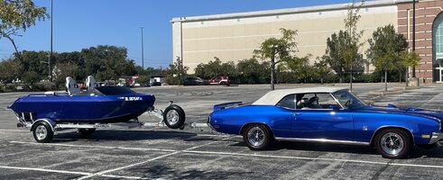

No way I'm towing a boat with a beautiful classic car like that - putting a hitch on that is sacrilegious!! :)
