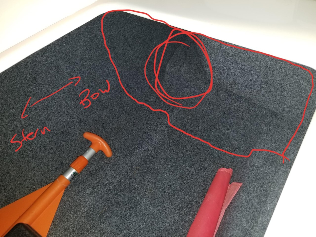

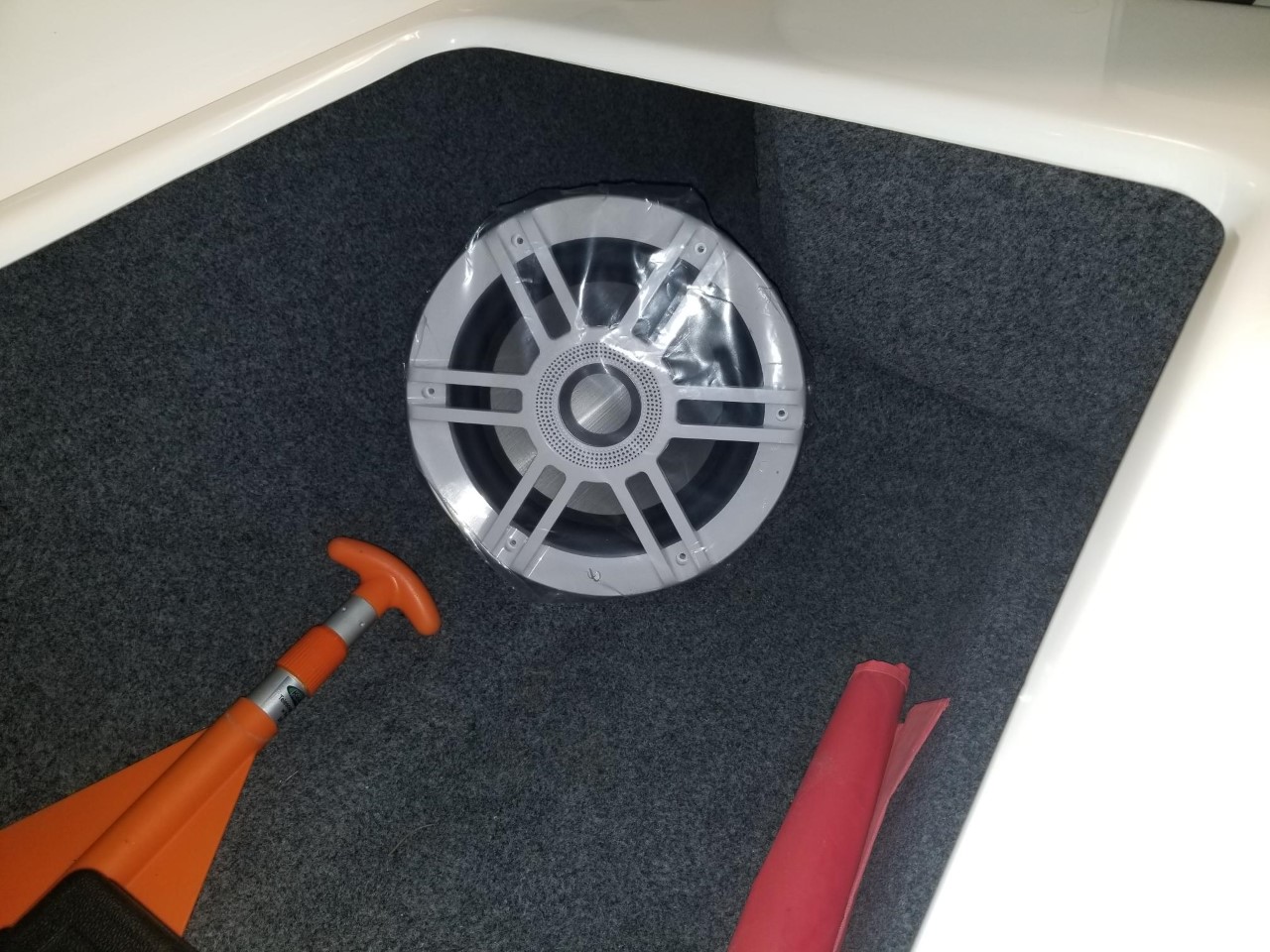

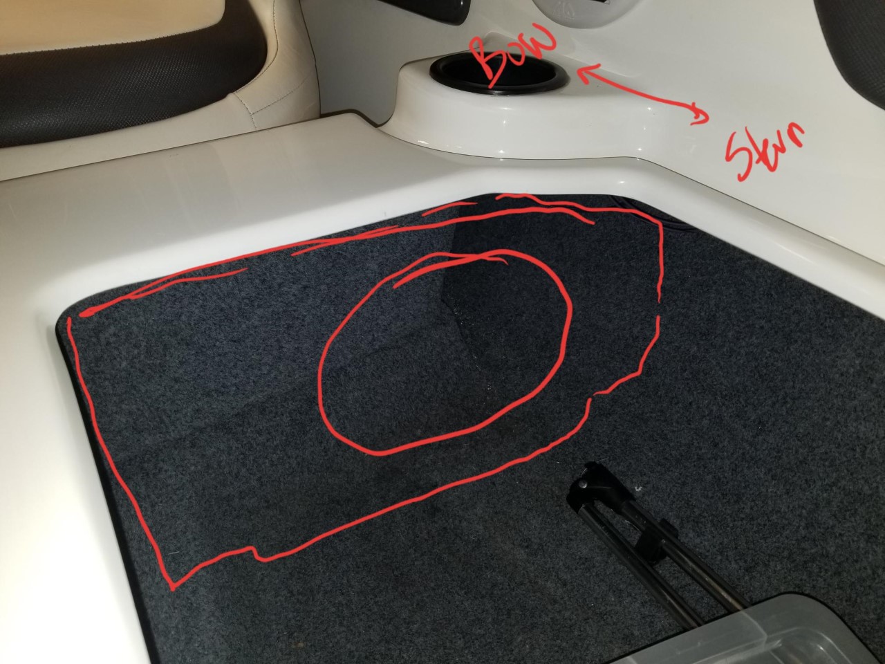

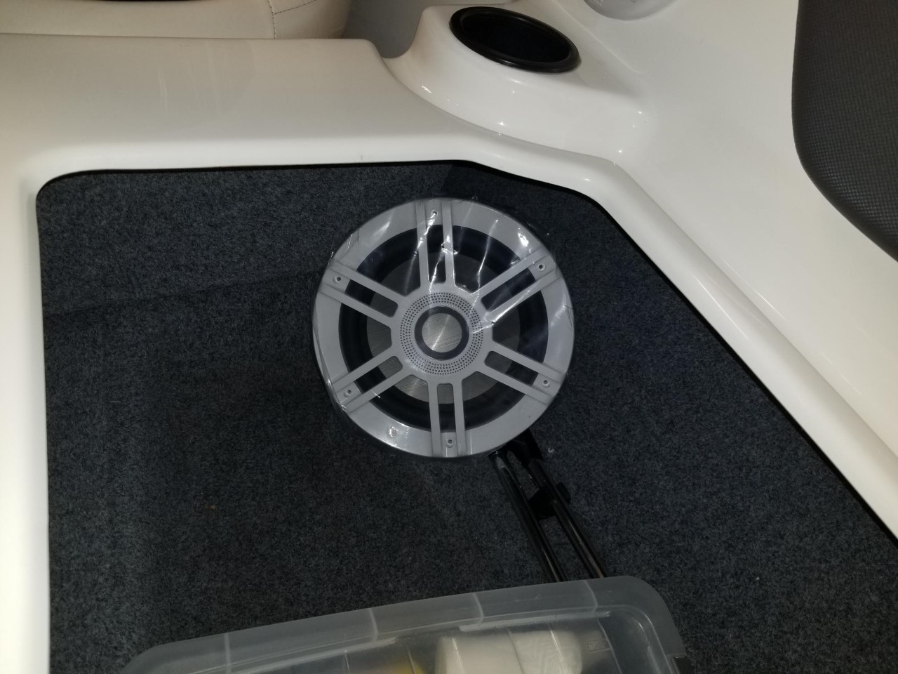

1. First thought is to build a panel that would securely hold the sub in these two locations as free air, and just cut enough under the seat cushion to vent into the cabin
2. Second thought is to use the same location, but build a box that would keep it in the corner and out of the way (not sure there is enough room for the size box that would be required because I have not found any information on minimum cubic feet needed if boxed)

I will have to check ripler, but I do not think so. I know they are too tall for the walls around the corner under the rear-side seats, which I think is the same height, because that was where I initially thought about putting them. I know that I cannot fit one in that position on the Port side because it has the side-facing bench seat and it is too tall to fit in that space.

Thanks Yamahaul, as I just mentioned to ripler, I will have to check whether one will fit behind the captain's chair or not, but with the side-facing bench seat, I know that one will not fit on the port side. These 10's are 11 5/8" from edge to edge.
