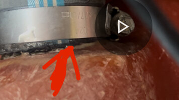

Found a pretty bad one: the through hull fitting for jet pump rod. The leak is not between the hose and fitting - but between the hull and the fitting.

Seems pretty fixable. As usual, finding the stupid thing is most of the battle. Well done. How did you ultimately figure it out? Any tips?
