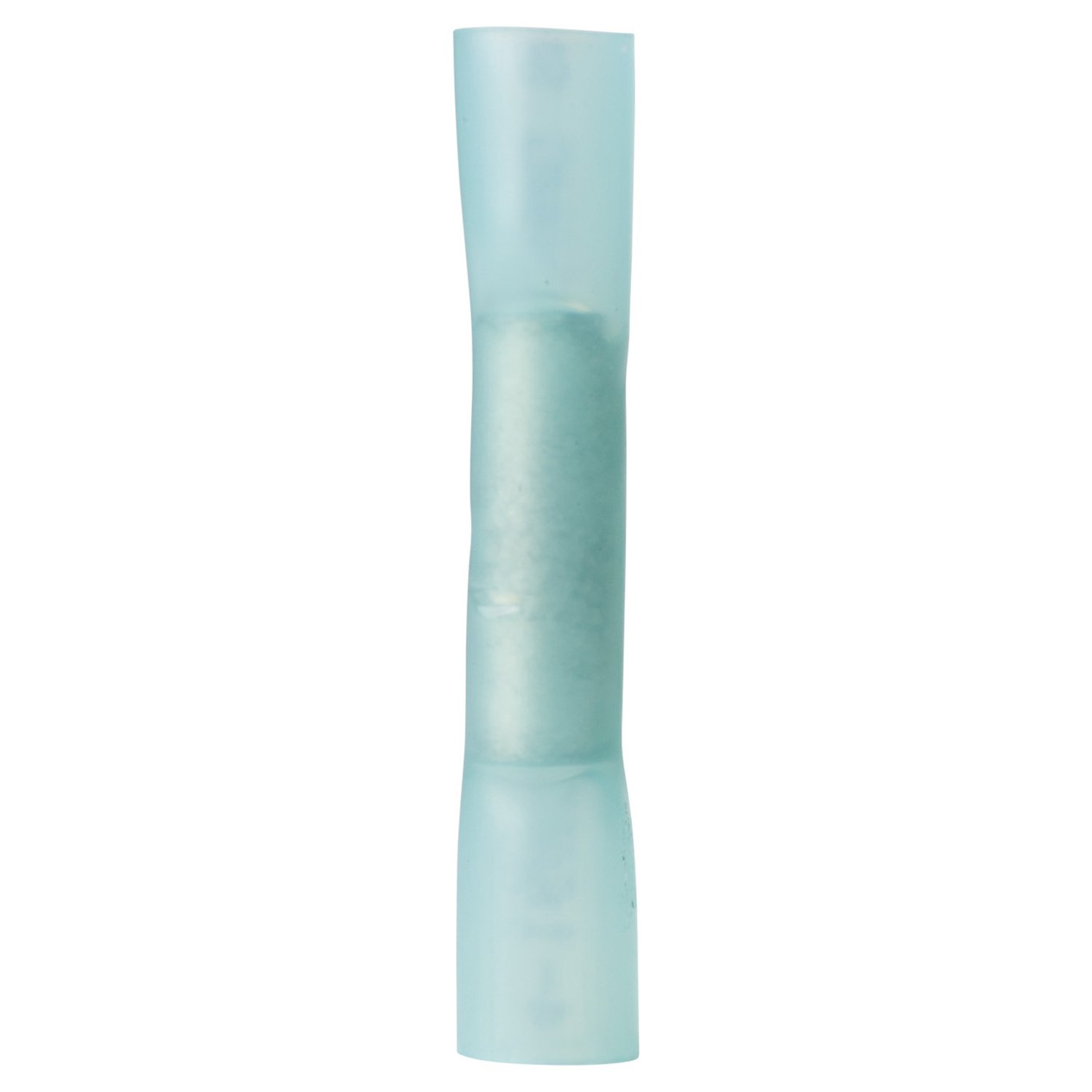

Personally, I would use the heat shrink butt splices and other connectors. Those scotch lock connectors promote corrosion and trouble down the road.

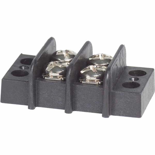

And if you are cutting a wire and dont like to jam 2 wires into the butt splice in order to create another run.....use a terminal block and do it up neatly.

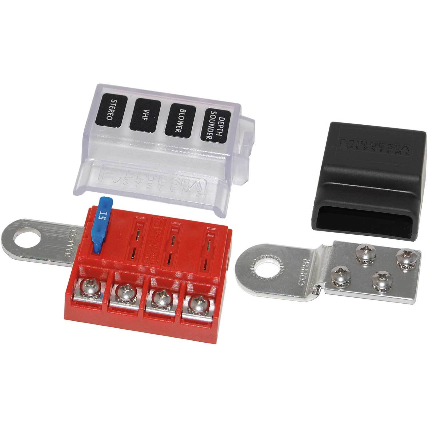

Or come straight off the battery and have a nice fuse right there.
I didn't realize you could add 2 wires to one side of the butt connector. I just did some testing with scrap wire and it worked with two 16 awg wires, but I had to use a 10-12 connector. For the single wire, I just stripped it a little longer and doubled it up. I was worried about the connector on the single wire side shrinking enough, but it did.
I tested it on the battery and got the same voltage as the battery on both ends.
