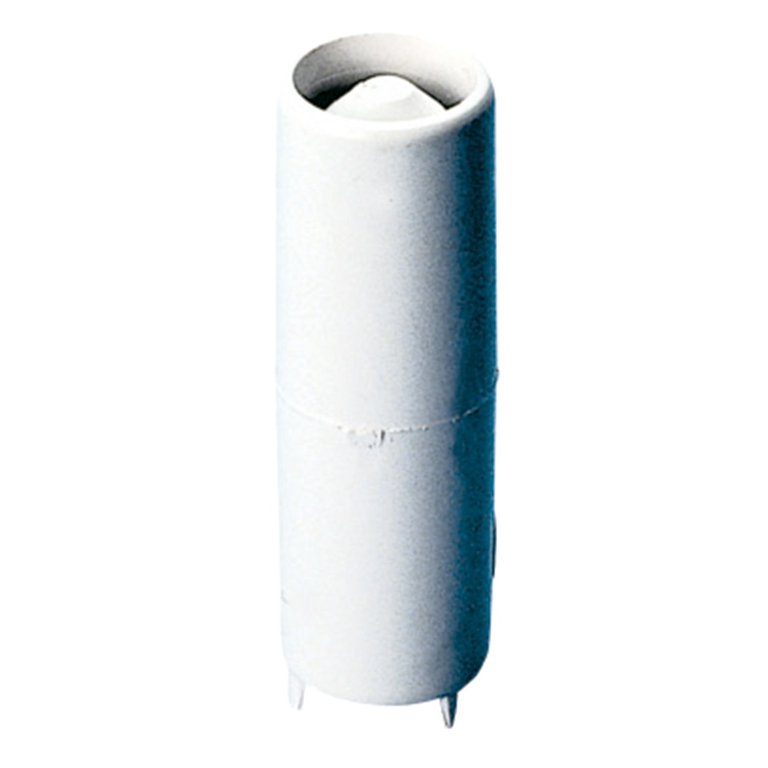

Suggestion for the check valve for the clean out tray drain or any drain line.
Looks like West Marine has them in stock..
@drewkaree Funny that you and @FSH 210 Sport both mention check valves.....
I installed one of these yesterday. I had to wrap some electrical tape around and put a hose clamp around it to get it to seal.
I will be testing it next week and will report resutls.
Day in Islamorada. After a couple of hours on the water and a bunch of Crazy Ivans to clear the weeds, the o-rings & check valve kept the water out of the clean out area. Four more days to go.
